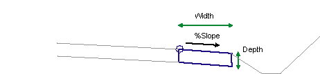

This subassembly creates a simple paved shoulder with finish grade and subbase.
The attachment point is at the inside edge of the shoulder on the finish grade.
Note: All dimensions are in meters or feet unless otherwise noted. All slopes are in run-over-rise form (for example, 4 : 1) unless indicated as a percent slope with a “%” sign.
Parameter |
Description |
Type |
Default |
Side |
Specifies which side to place the subassembly |
Left / Right |
Right |
Width |
Width of shoulder |
Numeric, positive |
0.9 m 3 ft |
Depth |
Depth from finish grade to subbase |
Numeric, positive |
0.2 m 0.67 ft |
%Slope |
% Slope of the shoulder |
Numeric |
-4% |
This section lists the parameters in this subassembly that can be mapped to one or more target objects. For more information, see To Specify Corridor Targets.
Target Parameters: None.
None.
The shoulder links are inserted outwards from the attachment point at the given width, slope, and depth.
In layout mode, this subassembly draws the lane using the input parameters.
