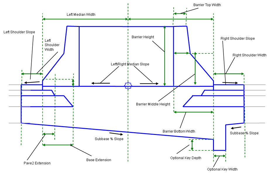

This subassembly is used to insert a central reserve at the centerline, with asymmetrical barriers on either side of the centerline, and a tapered bottom with an optional key.
The pavement structure follows the standards described in “Pavement Structure of Paved Sections" in the AutoCAD Civil 3D Help.
The attachment point is at the middle of the central reserve. The central reserve is placed on either side with appropriate components as specified by the input parameters.
Note: All dimensions are in meters or feet unless otherwise noted. All slopes are in run-over-rise form (for example, 4 : 1) unless indicated as a percent slope with a “%” sign.

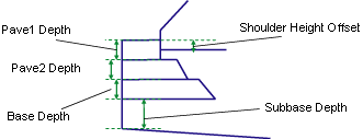

| Left Pave1 Depth | Depth between finish surface and Pave1 for the left shoulder | Numeric, positive |
0.025 m 0.083 ft |
| Left Pave2 Depth | Depth second level pavement material for the left shoulder | Numeric, positive |
0.025 m 0.083ft |
| Left Base Depth | Depth of base course (between Pave2 and Base) for the left shoulder | Numeric, positive |
0.100 m 0.333 ft |
| Left Subbase Depth | Depth of the subbase layer at the left inside edge of pavement (start of the left shoulder). If shoulder width is set to zero , then this is the depth of the subbase at left end of the central reserve. | Numeric |
0.300 m 1.0 ft |

This subassembly is inserted on both sides of attachment point, starting with the central reserve links, using left/right central reserve widths and other parameters. Edge of paved shoulder will be located (on both right and left sides) using Shoulder Height Offset parameter value. The finish surface of the shoulder is inserted for the given Shoulder Width and Shoulder Slope outward from the attachment point. The subbase link is inserted from the outer most point on the paved shoulders starting at the “Subbase Depth”, for left and right sides respectively, below the finish surface.
The Pave1, Pave2, and Base surface links are inserted parallel to the finish surface at the given depths. If the layer Extension values are non-zero, each layer is extended for the given distance beyond the shoulder hinge point. Each layer should be as wide as or wider than the one above it.
Finally, Barrier links are added from the end of the central reserves using the barrier bottom width, height, middle width, middle height and kerb height parameters.
