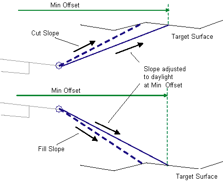

This subassembly inserts a link that daylights to a target surface at a user-defined cut or fill slope.
If necessary, the slope is adjusted to keep the daylight point beyond a minimum offset from the baseline.
You can also specify optional lined materials for daylight and other links (All Links, Daylight Links, Fill Links Only, and None).
The attachment point is at the hinge point of the daylight link. This component can be attached to either the left or right side.
Note: All dimensions are in meters or feet unless otherwise noted. All slopes are in run-over-rise form (for example, 4 : 1) unless indicated as a percent slope with a “%” sign.

This subassembly attempts to calculate a daylight point for the cut condition. If a daylight point is found, its offset is compared to the Min Offset value. If the daylight point is within the Min Offset, the daylight point is moved to the minimum offset point on the target surface. If no cut daylight point is found, the process is repeated for the fill condition.
If an offset horizontal alignment name is assigned to the Min Offset during corridor modeling, the value of the Min Offset will vary to match the offset of the alignment.
Like other daylight subassemblies, this subassembly optionally lets you add a lined material. You can specify three ranges of slopes. Material type 1 is applied if the slope of the links is up to the specified slope value. From slope 1 to slope 2, the second type of material applied. Similarly, if the slopes of links fall within slope 2 and slope 3 values, then material 3 is applied. If the link slopes are flatter than slope limit 3, then no material is applied.
If a lined material is added to the subassembly, then parallel links are added to the daylight links with specified thickness. This thickness parameter (for example, Material 1 Thickness) is measured perpendicular to the link. Bottom level links are coded with Datum and daylight links are coded with Top. Shapes enclosed by these materials are coded with material name.
In AutoCAD Civil 3D 2010 and previous versions, the Material Thickness parameter was measured vertically. In AutoCAD Civil 3D 2011 and later, this parameter is measured perpendicular to the link. Therefore, if you open a drawing containing these subassemblies that was created in AutoCAD Civil 3D 2010 or prior in AutoCAD Civil 3D 2011 or later, and then rebuild the corridor(s), this parameter will be changed to reflect the new behavior. Any volume reports that use this subassembly will be updated to reflect the new behavior.
In layout mode, this subassembly displays both the cut and fill slopes in dashed lines extended outward for the Min Offset distance. The daylight links are terminated with arrowheads pointing outwards.
