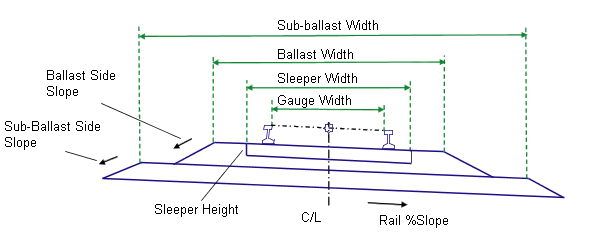

This subassembly inserts the rails, sleeper, ballast, and sub-ballast for a single-track railroad.
It should be followed with a Daylight subassembly on the left and right sides to close to existing ground in cut and fill situations.
This subassembly is designed for visualization and to demonstrate the use of corridor modeling for rail applications. It is not intended for actual engineering production work.
The attachment point is at a distance equal to the rail height above the centerline of the sleeper.
Note: All dimensions are in meters or feet unless otherwise noted. All slopes are in run-over-rise form (for example, 4 : 1) unless indicated as a percent slope with a “%” sign.
Parameter |
Description |
Type |
Default |
Rail % Slope |
% slope of the roadbed |
Numeric |
0 (%) |
Gauge Width |
Width of the rail gauge from inside-to-inside rail. The rails are placed symetrically about the centerline alignment. |
Numeric, positive |
1.435 m 4.7083 ft (4’ 8-1/2”) |
Sleeper Width |
Width of the sleeper, placed symetrically about the centerline |
Numeric, positive |
2.4 m 8.0 ft |
Sleeper Height |
Height of the sleeper |
Numeric, positive |
0.200 m 0.67 ft |
Ballast Width |
Width of the top of the ballast layer, placed symetrically about the centerline |
Numeric, positive |
3.6 m 12.0 ft |
Ballast Depth |
Thickness of the ballast layer from finish surface |
Numeric, positive |
0.3 1.0 ft |
Ballast Side Slope |
Side slope (x : 1) of the ballast layer |
Numeric, positive |
2 (: 1) |
Sub-ballast Width |
Width of the top of the sub-ballast layer, placed symetrically about the centerline |
Numeric, positive |
6.6 m 22.0 ft |
Sub-ballast Depth |
Thickness of the sub-ballast layer |
Numeric, positive |
0.3 1.0 ft |
Sub-ballast Side Slope |
Side slope of the sub-ballast layer |
Numeric, positive |
2 (: 1) |

The links for the rails, sleeper, ballast, and sub-ballast are calculated and placed based on the input parameter values provided. If the Rail %Slope is non-zero, the corridor profile level is held at the center of the rail on the low side. The finish surface, sleeper, ballast, and sub-ballast links are maintained at the Rail %Slope.
In layout mode, this subassembly displays the links comprising the finish surface, ballast, sub-ballast, and side slopes.
Point, Link, or Shape |
Constant |
Description |
P1, P4 |
EBS |
Edge of ballast shoulder |
P2, P3 |
ESL |
Edge of sleeper |
P8,P9 |
Daylight_Ballast |
Daylight point for the ballast layer |
P7, P10 |
ESBS |
Edge of subballast shoulder |
P11, P12 |
Daylight_Subballast |
Daylight point for the sub-ballast layer |
All rail points |
R1, R2, ..… |
Numbered sequentially for longitudinal connection (not shown in diagram) |
L1, L3 |
Top, Ballast |
Finish surface on ballast layer |
L2 |
Top, Sleeper |
Finish surface on top-of-sleeper |
L4, L6 |
Sleeper |
Sides of sleeper |
L7, L8 |
Top, Ballast |
Sideslopes on ballast layer (side slopes) |
L10 |
Ballast |
Bottom of ballast |
L9, L11, L12, L14 |
Top, Subballast |
Finish surface on subballast layer |
L13 |
Subballast |
Bottom of subballast |
S1 |
Sleeper |
S2 |
Ballast |
S3 |
Subballast |

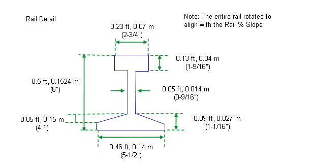

Rail shapes |
Rail |
Not shown in diagram |
