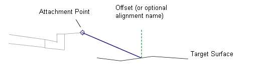

The attachment point is at the beginning of the link.

Behavior
A link is extended to the point on the target surface at the given offset.

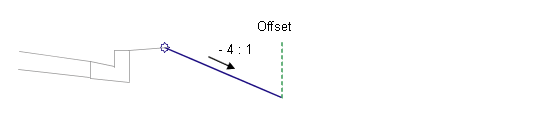

Layout Mode Operation
In layout mode, this subassembly displays the link drawn to the given offset at a -4 : 1 slope. The link terminates with an arrowhead pointing outwards.
