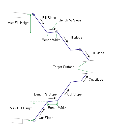

This subassembly inserts links to create cut or fill catch slopes with repeating benches as needed.
You can also specify optional lined materials for daylight and other links (All Links, Daylight Links, Fill Links Only, and None).
The attachment point is at the inside edge of the initial cut or fill slope. This component can be attached to either the left or right side.

The initial hinge point is set at the attachment point. The hinge point level is checked against the target surface to determine if the section is in the cut or fill condition. An intercept is calculated to the target surface using the given Cut Slope or Fill Slope. If the height to the intercept exceeds the Max Height, the link with the Max Height is inserted, and the bench link is added. The hinge point is reset to the outside edge of the bench and the process is repeated until a daylight link is found that does not exceed the Max Height.

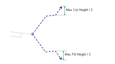

In layout mode, this subassembly draws the initial cut and fill slopes to their maximum heights, a single bench, followed by cut and fill daylight slopes for half the maximum heights. The daylight links terminate with an arrowhead pointing outwards.
