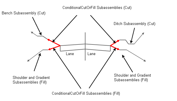

The following illustration shows a corridor assembly section comprised of:

Multiple ConditionalCutOrFill Subassemblies
Multiple ConditionalCutOrFill subassemblies may be attached to a common point on an assembly. This includes multiple cut and or multiple fill ConditionalCutOrFill subassemblies, as shown in the following illustration.
This illustration shows only the right side of the assembly. The following table describes the components included on this side of the assembly.
Component Description
A Assembly baseline
B Right side Lane subassembly
C ConditionalCutOrFill subassembly, with Type parameter set to Cut. If the condition is in cut, and the cut condition is between the minimum/maximum distance values specified for subassembly (C), then a specified type of subassembly (G) is applied.
D ConditionalCutOrFill subassembly, with Type parameter set to Cut. If the condition is in cut, and the cut condition is between the minimum/maximum distance values specified for subassembly (D), then a Ditch subassembly (H) is applied.
E ConditionalCutOrFill subassembly, with Type parameter set to Fill. If the condition is in fill, and the fill condition is between the minimum/maximum distance values specified for subassembly (E), then a specified type of subassembly (I) is applied.
F ConditionalCutOrFill subassembly, with Type parameter set to Fill. If the condition is in fill, and the fill condition is between the minimum/maximum distance values specified for subassembly (F), then a specified type of subassembly (J) is applied.
G A specified type of subassembly that is applied in cut conditions that are between the minimum/maximum distance values specified for subassembly (C).
H A specified type of subassembly that is applied in cut conditions that are between the minimum/maximum distance values specified for subassembly (D).
I A specified type of subassembly that is applied in fill conditions that are between the minimum/maximum distance values specified for subassembly (E).
J A specified type of subassembly that is applied in fill conditions that are between the minimum/maximum distance values specified for subassembly (E).
You control the cut or fill limit heights using the Minimum Distance and Maximum Distance input parameters. The Layout Width and Layout Gradient input parameters let you control the position of the graphics displayed by this subassembly when it is drawn in layout mode.
