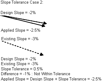

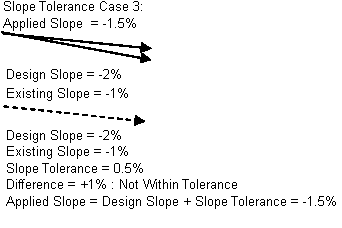

Slope Tolerance
The value that the Overlay Slope is allowed to vary from its design value. The slope tolerance is not used if the Overlay Slope is given as M (see Behavior below for details).
Numeric, positive
0.5%

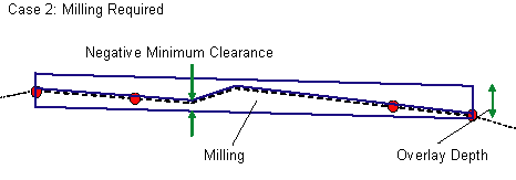

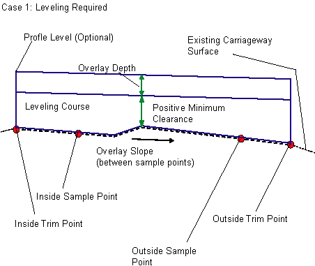

Minimum Clearance (+/-)
The minimum vertical clearance between the existing surface and the bottom of the overlay layer. A positive value places the bottom-of-overlay link above the existing surface, creating a Leveling layer beneath the overlay. A negative value places the bottom-of-overlay link below the existing surface, creating a Milling layer that coincides with a portion of the Overlay layer.
Numeric
0.100 m
0.30 ft

The slope of the Existing Surface is determined between the inside and outside sample points. The slope of the overlay layer is determined by the following steps:
  1. If the Overlay %Slope input is given as M, then the overlay slope matches the slope from the Inside Sample Point to the Outside Sample point.
  2. If the Overlay %Slope is given as S, then the overlay uses the outside lane superelevation slope defined for the corridor alignment. The left side slope is used if the Outside Sample Point is to the left of the Inside Sample Point, otherwise the right side superelevation slope is used.
  3. If a numeric value is given for the Overlay %Slope, the given value is used.
  4. If a numeric value or the superelevation slope is used, the overlay slope is compared to the existing slope between the sample points. If the difference exceeds the Slope Tolerance value, the design slope is adjusted up or down by the Tolerance value to make it more closely match the existing slope and minimize the amount of leveling or milling. Slope adjustment does not occur if the Slope Tolerance is zero.
Overlay Levels
The levels of the overlay points are determined as follows:
  1. If the Use Profile value is True, the level of the corridor profile is held at the Inside Trim offset on the top of overlay. The overlay is extended at the overlay slope to the Outside Trim offset, and a parallel link is inserted for the bottom-of-overlay. Any areas above the existing surface and below the bottom-of-overlay are stored as closed shapes with code “Level”. Areas below the existing surface and above the bottom-of-overlay are stored as closed shapes with code “Mill”.
  2. If the Use Profile value is False, the bottom-of-overlay link is shifted vertically to hold to the Minimum Clearance above or below the existing surface. A positive Minimum Clearance creates a leveling area above the existing surface and below the bottom-of-overlay. A negative clearance creates a milling area below the existing surface and above the bottom-of-overlay.

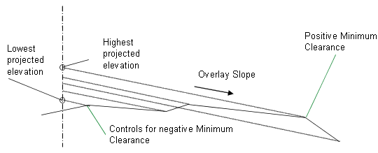

Minimum Clearance Point
The method of determining the point where the Minimum Clearanceapplies is shown in the diagram below.
  1. A vertical projection line is established at any arbitrary offset.
  2. Each point on the Existing Surface between the two trim points is projected back to the projection line at the Overlay Slope.
  3. The point with the highest level on the projection line is the control point for a Minimum Clearance value greater than zero. The one with the lowest is the control point for a Minimum Clearance value less than zero.
