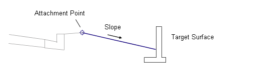

Behavior
A link is extended to the left or right from the attachment point at the given slope until it intersects the target surface.
By default, a cut or fill link will be added from the attachment point to the target surface. If the link needs to be added only in cut or fill conditions, specify appropriately a value for the Add Link In property of the subassembly. If the cut link and fill links must be at different slopes, then add this subassembly twice, at the same attachment point, once for Cut Only and then again for Fill Only conditions, with slopes as needed.

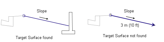

Layout Mode Operation
In layout mode, this subassembly attempts to find the intersection of the link, if the target surface was inserted by a previous subassembly. If an intersection is found, the link is displayed at the given slope to the surface. If not, the link is displayed at the given slope outward for a slope distance of 3 meters or 10 feet, terminating in an arrowhead pointing outward.
