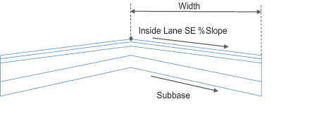

This subassembly creates a crowned lane that has separate subbase slope control, as well as the ability to control the subbase crown location by specifying a target alignment.
The attachment point is at the beginning of the first link. The subassembly is sensitive to the direction being inserted. Positive widths increase the offset from the attachment point in the direction inserted.
Note: All dimensions are in meters or feet unless otherwise noted. All slopes are in run-over-rise form (for example, 4 : 1) unless indicated as a percent slope with a “%” sign.

The Inside Lane superelevation slope is obtained from the superelevation specifications for the baseline alignment. Starting at the attachment point, a finish surface and parallel subgradient are inserted using the given width, depth, and the superelevation slope. Vertical links close the shape at either end of the lane.
If an offset horizontal alignment name is assigned to the Left or Right width during corridor modeling, the width of the lane will vary to match the offset of the alignment.
If an alignment is specified for base centerline then the crown point of the base and subbase layers will shift to the location of this alignment.
