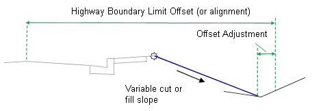

This subassembly inserts a daylight link from the attachment point to a given offset from the highway boundary limit on a target surface.
You can also specify optional lined materials for daylight and other links (All Links, Daylight Links, Fill Links Only, and None).
The attachment point is at the inside edge of the daylight link.

HB Offset from Baseline |
+/- offset of the highway boundary limit from the baseline. Specifying a positive value for the this parameter inserts this subassembly on the right side of a corridor, or controlling baseline. A negative value inserts it on the left side. For more information, see "Inserting Subassemblies on Right and Left Sides of a Corridor" in the Corridors chapter of the AutoCAD Civil 3D User's Guide Help. |
Numeric |
3.0 m 10.0 ft |

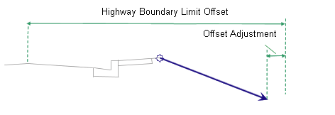

Offset Adjustment |
+/- value added to the HB Limit Offset. A negative adjustment value moves the daylight point inside of the HB limit; a positive value moves it outside the HB limit. |
Numeric |
0.0 |

The daylight offset is calculated as the HB Limit Offset plus or minus the Offset Adjustment. A daylight link is inserted from the attachment point to the calculated offset on the target surface.

In layout mode, this subassembly displays a link extending outwards at a -4 : 1 slope to the highway boundary offset, plus or minus the offset adjustment. The daylight link terminates with an arrowhead pointing outwards.
