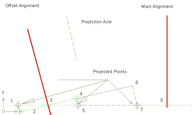

The following diagram illustrates how the LinkToMarkedPoint2 subassembly functions, as well as how it displays in a cross-section for the offset baseline portion of the corridor.
The LinkToMarkedPoint2 subassembly does either of the following, both of which have the same result:
Note that the new LinkToMarkedPoint2 subassembly should not rely on the fact that point #7 will be at a constant offset at all stations along the main alignment.
Offset Baseline Corridor Cross-Section
Note the following:
  • The cross-section sample line is orthogonal to the main baseline at point #8 (line alpha).
  • The cross-section sample line is composed of one or more segments, with all segments collinear.
  • The corridor point data for the offset portion of the corridor has offset values stored relative to the offset baseline.
  • To project this corridor point data in the cross-section from line beta to line alpha for display in the cross-section view, the offset will need to be divided by cosine (angle gamma).
Note that using this approach, a lane subassembly on the offset portion of the corridor that is defined to be 3.5 meters in width, will be slightly wider than 3.5 meters in width when shown in the corridor cross-section.
