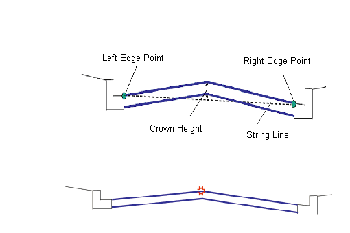

This subassembly creates a simple crowned roadway between two edge-of-pavement points.
To use this subassembly, you should have separate alignments defining the left and right edges. Elevations at these points could come from surfaces or profiles. Furthermore, if the component defining the edges (for example, curb and gutter) is also a rehab component, then they could be passed in as marked points, thus transferring offset and elevation information.
The attachment point is (near) the crown point of the subassembly. This is typically at the assembly baseline point. While in layout mode, this point coincides with crown point, in the corridor state the finshed grade profile point (or baseline marker point) may not be the same as crown point since its offset and elevation are computed by edge of pavement data.

Left Edge of Pavement
From the attachment point, the left edge of the pavement point is located based on: (a) the location of the alignment through "Left Edge" target parameter, (b) if this is not provided, it is based on the assigned marked point (to Left Edge), or (c) if both of these are not provided, then it is based on the default (Left Edge) offset value.
Similarly, the elevation for this point is computed based on: (a) Left Edge profile target parameter, (b) if this is not provided, then it determines the surface elevation from "EGTopSurf" Logical assignment, or (c) if these two are not provided, the assigned marked pointdetermines the elevation. An error message results if none of these two conditions are met and the corridor fails to build.
Right Edge of Pavement
From the attachment point, the right edge of the pavement point is located based on: (a) the location of the alignment through "Right Edge" target parameter, (b) if previous is not provided, based on the assigned marked point (to Right Edge), or (c) if both are not provided based on the default (Right Edge) offset value.
Similarly , the elevation for this point is computed based on: (a) Right Edge profile target parameter, (b) if this is not provided, then it determines the surface elevation from "EGTopSurf" Logical assignment, or (c) if these two are not provided, then the assigned marked point determines the elevation. An error message results if none of these two conditions are met and the corridor fails to build.
Crown Point
Crown Point (offset) is located at halfway between the left edge and right edge of pavements.
Elevation of the crown point is the sum of "average elevation of left and right edges" and the "crown height" parameter value.
Bottom of Overlay
Bottom of overlay surface is computed by offsetting the proposed finish grade (Left Edge point to New Crown Point to Right Edge Point) by Overlay depth value.
In layout mode, this subassembly inserts one lane each on either side of the attachment point. First two edge points will be located based on left/right offsets. These left and right point elevations are calculated (in layout mode) by subtracting crown height from the ordinate of attachment point. Then the "Crown Point" is located halfway between these two points. However, since the programatic defaults are the same for both left and right, by default the crown point matches with baseline marker point. Lane slopes in layout mode are equal to the "Min % Slope" value. Thickness of pavement is equal to Overlay depth.
