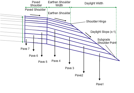

This subassembly inserts a paved and an earthen (unpaved or gravel) shoulder with all pavement, base, and subbase layers extended to the subgrade shoulder point.
The attachment point is at the beginning of the first link. This subassembly is sensitive to the direction being inserted. Positive widths increase the offset from the attachment point in the direction inserted.
Note: All dimensions are in meters or feet unless otherwise noted. All slopes are in run-over-rise form (for example, 4 : 1) unless indicated as a percent slope with a “%” sign.

| Paved Shoulder Width | Width of the Shoulder that is paved. | Numeric, positive |
1.0 m 3 ft |
| Paved Shoulder Slope Specification | Specifies how the paved shoulder slope will be calculated. User also has the option to set a parameter reference and use the Pavement Slope of an adjacent lane to define the top slopes of the shoulder. The behavior of the top of shoulder slope when this option is selected is described in the Behavior section. | List of options: a) Default, b) Use Inside Shoulder SE, c) Use Outside Shoulder SE | Default |
| Default Paved Shoulder Slope | Default crossfall of the paved shoulder surface | Slope | -4.0% |
| Earthened Shoulder Width | Width of the Shoulder that is unpaved | Numeric, positive | |
| Earthened Shoulder Slope Specification | Specifies how the unpaved shoulder slope will be calculated. User also has the option to set a parameter reference and use the Pavement Slope of an adjacent lane to define the top slopes of the shoulder. The behavior of the top of shoulder slope when this option is selected is described in the Behavior section. | List of options: a) Default, b) Use Inside Shoulder SE, c) Use Outside Shoulder SE | Default |
| Default Earthened Shoulder Slope | Default crossfall of the unpaved shoulder surface. | Slope | -4.0% |
| Daylight Width | Specifies the shoulder daylight width | Numeric, positive |
1.0 m 3 ft |
| Daylight Slope | Slope of the Foreslope of the shoulder, which extends from the Shoulder Hinge Point to the Subgrade Shoulder Point | Slope | 2: 1 |

The shoulder is inserted using width and depth parameters provided. The slope of the subgrade surface can also be set using a parameter reference that sets the slope equal to that of the subgrade surface of an adjacent lane. You can also enter a fixed slope, if desired. The slopes of all base surfaces will follow the slope of the subgrade surface. When an alignment is used to define the Width to Subgrade Shoulder Point, the Foreslope of the Shoulder parameter is ignored. The shoulder subassembly ties in to the pavement layers (even if the outside edges of the pavement layers are extended).
