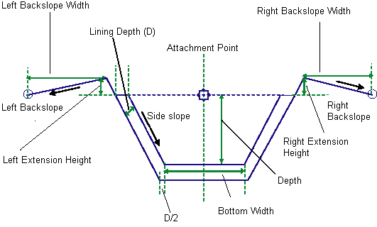

This subassembly creates an open channel with optional lining and backslope links.
The attachment point is located above the midpoint of the bottom width, at a height equal to the Depth parameter.
Note: All dimensions are in meters or feet unless otherwise noted. All slopes are in run-over-rise form (for example, 4 : 1), unless indicated as a percent slope with a “%” sign.

This subassembly builds an open channel shape using the input parameters. The attachment point is typically at the start of the baseline, at associated alignments and profiles. The bottom link of the channel is then drawn using a specified width. Using the sideslope parameter, the channel sides are drawn on either sides.
For the channel lining depth, if a non-zero positive value is specified for the Lining Depth parameter, then a material lining is drawn around the channel. The Lining Depth is measured perpendicular to the side of the slope, as shown in the previous diagram. If a zero value is specified for the Lining Depth, then no links are inserted.
Similarly, if a zero value is specified for left or right extensions and backslope widths, those links are omitted, or are not drawn. Extension height can be controlled with a target parameter profile association. Similarly, the height of the backslope end point can be specified to a profile. To force the outer backslope point to the channel top elevation, associate this point to the channel’s finish grade profile, to which this assembly is attached.
If the Backslope Width is omitted, the Right Marked Point is located on the outer point of channel height extension. If the Channel Height Extension link is also omitted, then the marked point is located on the outermost point on the channel top.
In AutoCAD Civil 3D 2010 and previous versions, the Lining Depth parameter was measured vertically. In AutoCAD Civil 3D 2011 and later, this parameter is measured perpendicular to the side slope. Therefore, if you open a drawing containing these subassemblies that was created in AutoCAD Civil 3D 2010 or prior in AutoCAD Civil 3D 2011 or later, and then rebuild the corridor(s), this parameter will be changed to reflect the new behavior. Any volume reports that use this subassembly will be updated to reflect the new behavior.
In layout mode, this subassembly draws as it is defined using the input parameters, starting from the attachment point.
