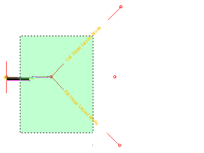

Add a daylight subassembly
  1. In the Tool Palettes window, on the Basic tab, click BasicSideSlopeCutDitch.
  2. In the Properties palette, under ADVANCED, specify the following parameters:
    • Side: Right
    • Cut Slope: 2.000:1
    • Fill Gradient: 4.000:1
  3. In the drawing, click the marker point at the outside edge of the sidewalk subassembly.
  4. Press Esc.
    This action ends the subassembly placement command.

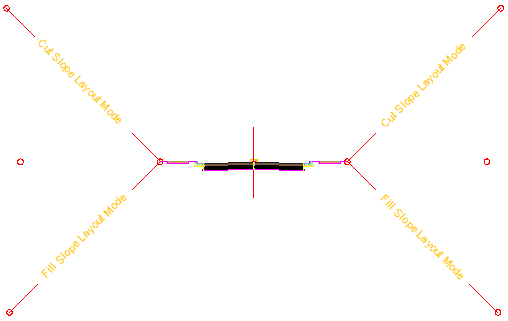

Mirror the subassemblies to the left of the baseline
  1. In the drawing, select the four subassemblies you added.
  2. Right click. Click Mirror.
  3. Click the marker point on the assembly baseline.
    The subassemblies are displayed on the left side of the assembly marker. The Mirror command creates a mirror image of the selected subassemblies. All the subassembly parameters, except for the Side parameter, are retained.
    Note:
    The parameters of the mirrored subassemblies are not dynamically linked. If you change a parameter value for a subassembly on one side of the assembly baseline, the change will not be applied to the opposite side.
