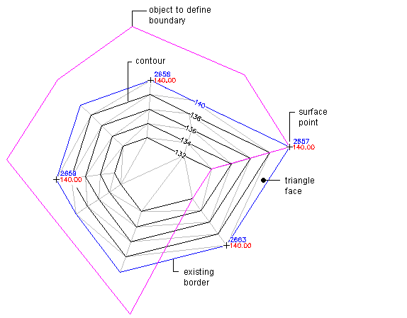

Boundaries

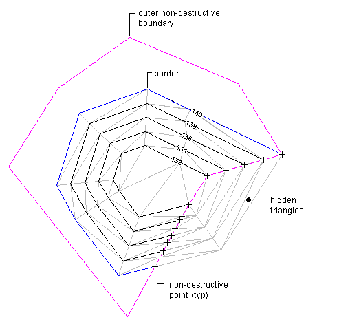

Boundaries are closed polylines that affect the visibility of the triangles either inside or outside the polylines. An outer boundary defines the extents of the surface. All triangles inside the boundary are visible, and all triangles that are outside the boundary are invisible.
Areas hidden by boundaries are not included in calculations, such as total area and volume.
Surface boundaries are defined by selecting existing polygons in the drawing. The surface definition displays the numerical ID and a list of vertices for each boundary.
A surface before adding a non-destructive outer boundary
The effects of a non-destructive outer boundary
