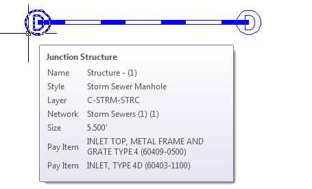

Add parts with rate items to the pipe network
panel
Find. This action creates two structures that are connected by a pipe.
The tooltip displays the description and ID of each rate item that has been assigned to that structure.
