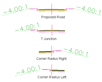

  1. Zoom in to the assemblies on the right-hand side of the surface.
  2. On the Proposed Road assembly, select the baseline.
    Note:
    Do not use the grips to drag the baseline marker.
  3. Click the bottom of the baseline marker. Drag the baseline onto the Tutorial Assemblies tool palette.
    The image and name of the assembly are displayed on the tool palette.
  4. Repeat Steps 2 and 3 for the remaining three assemblies.
