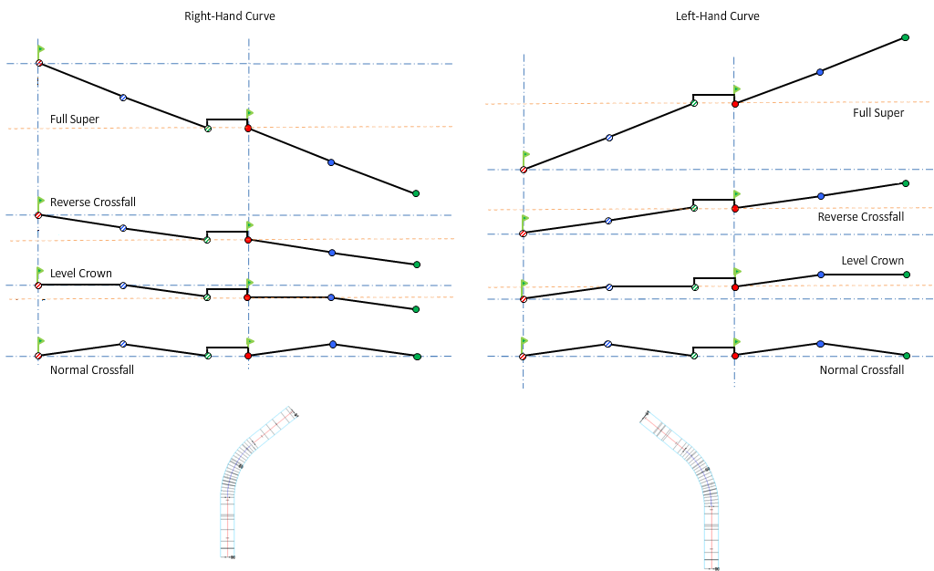

The following illustration describes the Left Side pivot method for a dual crowned carriageway.
Maintain Central Reserve Shape means when superelevation is applied, the central reserve will raise to accommodate the superelevation. This option maintains the central reserve shape, and the
pivot points raise or lower.
For an explanation of superelevation diagrams, see About Superelevation Axis of Rotation Pivot Methods.
