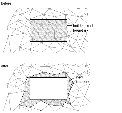

A boundary affects the visibility of the surface triangles inside it.
When you create boundaries, you specify whether they use arc tessellation and non-destructive breaklines.
Surface boundaries are defined from closed polygons, such as a closed polyline or a plot, or from surfaces. Surfaces may be selected as boundaries when the Hide boundary type and the Non-destructive breakline options are both selected.
