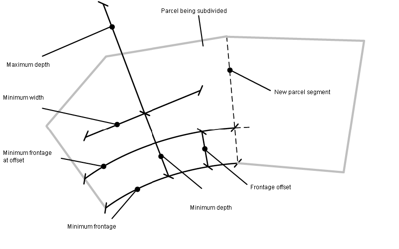

You can define plot sizing criteria when creating or editing plots by subdividing existing plots.
