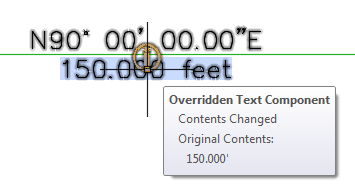

- Format Changed: Indicates that the format of the label has changed, but the contents have not changed. In the following illustration, the colour of the distance label was changed to red.
- Contents Changed: Indicates that either the contents of the label have changed, or the contents and the format have changed. In the following illustration, the foot symbol (') was changed to feet.
