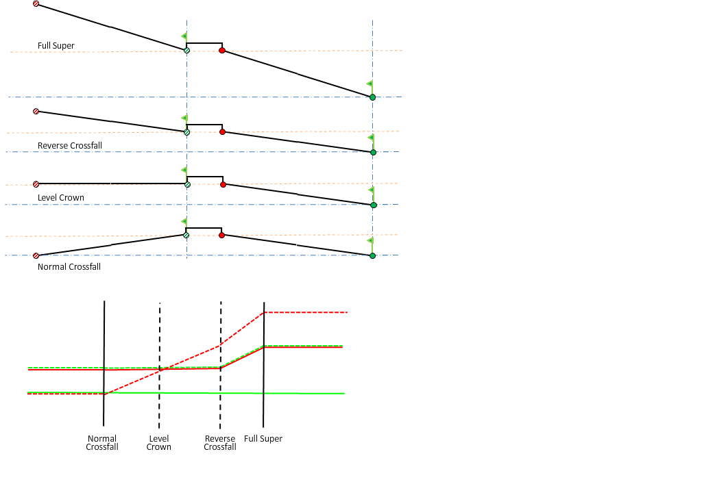

The following illustration describes the Inside of Curve pivot method for a dual planar carriageway.
Maintain Central Reserve Shape means when superelevation is applied, the central reserve will raise to accommodate the superelevation. This option maintains the central reserve shape, and the
pivot points raise or lower.
