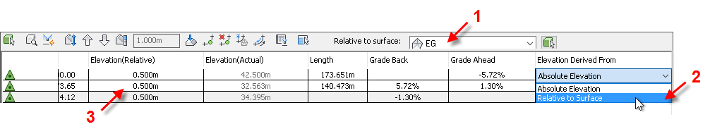

When you open the Grading Level Editor for a feature line that is set to be relative to a surface, you will see the selected surface listed in the Grading Level Editor and the editable feature line points will be shown as being relative to the surface.
You can specify relative level options by using the following features in the Grading Level Editor.
For a feature line that was not previously set to be relative to a surface, when you open the Grading Level Editor and then select a surface from the Relative to Surface list, the Level Derived From column is initially set to Absolute Level for all points and does not automatically change to Relative to Surface. Use the drop-down list to select Relative to Surface for the points that you want to be relative.
