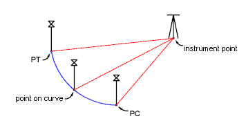

The following illustrates the Three Point Curve command:
C3
