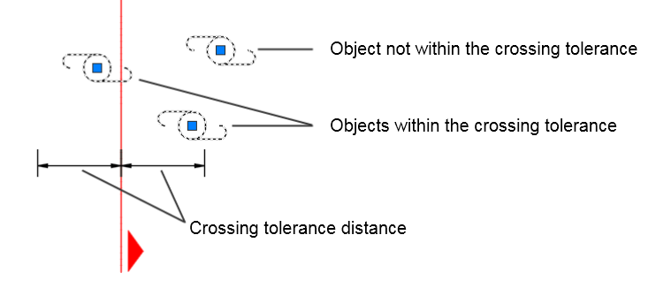

Specifies the distance within which an object must be from a sample line to be displayed as a crossing.
For example, if this value is set to 1 feet, an object's centroid grip can be within one feet of the sample line and still be displayed as a crossing in a section view.
If this value is set to zero, the object's centroid grip must be exactly on the sample line in order to be displayed as a crossing in a section view.
The maximum value that you can specify for this setting is 15 feet or 5 metres.
