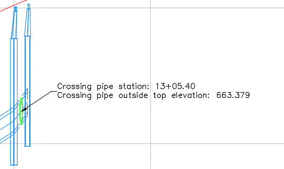

You can label the crossing pipe locations in profile views and section views.
Labeling crossing pipe locations may result in having two labels on a pipe (one regular pipe label and one crossing pipe label). If this is not desirable, you can use the Null label styles that are provided in the AutoCAD Civil 3D templates. Null label styles are set as the default styles for crossing pipe labels.
Labels
Crossing Profile and use the context menu to create or edit a label style. Several crossing pipe properties are provided in the Text Component Editor which you can use to label the crossing pipe chainage and level information.
Add Labels, and then select either Entire Network Profile or Single Part Profile. You can drag the label off the pipe as needed as shown in the following illustration.
If the crossing pipe is moved to a different chainage along the alignment, the labels will be updated with the new chainage and level information.
