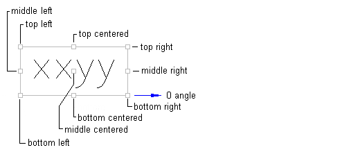

Specifies the location on the text component that is attached to the anchor point. Attachment points are calculated based on a rectangle that encompasses the text, the size of which is determined by including the Gap value specified in the Border category. The following illustration shows text attachment points:

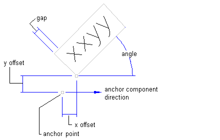

Specifies the offset distance between the attachment point and the anchor point in the X direction (zero angle direction).
The X direction is determined by the object to which the text component is anchored. If the text component is anchored to the label insertion point, then the X direction is determined in relation to the following Orientation Reference settings on the General tab:
Specifies the offset distance between the attachment point and the anchor point in the Y direction, which is 90 degrees counterclockwise to the X direction.

Specifies the distance between the border and text. The Gap is still applied if Border Visibility is set to False.
