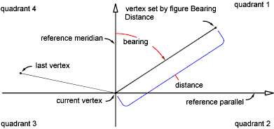

Create a new vertex in a specified direction from the current figure vertex. At least one vertex must exist in the figure for this command to work properly.
Survey Command Window. FIGURE BRG-DIST [quadrant bearing] [quadrant] [distance]
BEG BFIG
FIG NE 1000 1000
FIG BD 61.1111 1 30.480
WHOLE CIRCLE BEARING: 61.1111 DISTANCE: 30.4800
NORTH: 1014.6902 EAST: 1026.7063
END
The following illustrates the Figure Quadrant Bearing Distance command:
Command Synonym
FIG BD
| Parameter | Definition |
| quadrant bearing | The desired quadrant bearing. Enter this value in the current survey database angular units, either DMS, grads, decimal degrees, mils, or radians. |
| quadrant | Specify the quadrant using one of the following numbers: 1 (for NE), 2 (for SE), 3 (for SW), or 4 (for NW). |
| distance | The measured distance from the current vertex to the new vertex. Enter this value in the current survey database distance units. |
