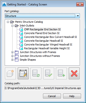

From the dialog box, you can choose to work with the pipe catalog or structure catalog and navigate through the categories within that catalog.
The icons on this dialog box let you perform several tasks. If you position your mouse over an icon, a tooltip provides an explanation of the icon. Icons are activated based on what is selected in the catalog tree.
| If you want to… | then do this … |
|  create a new part | select a chapter folder then click New Parametric Part. Enter a name and description for the new part on the New Part dialog box, and click OK. After doing this, the building environment is opened for part creation. |
|  modify an existing part size | select the part in the catalog tree, and click Modify Part Sizes. The building environment is opened for modifying the part. |
|  regenerate the catalog | after making changes to parts or to a catalog, click Catalog Regen to regenerate the entire pipe or structure part catalog. |
|  test (validate) the catalog | after making changes to a catalog, click Catalog Test to verify that the validation is successful. |
|  add a new chapter for a part | click New Chapter and enter a name. You can add chapters to the catalog or to another chapter. |
|  delete a part | select the part and click Delete. The part is deleted from the catalog and is removed from the catalog tree. |

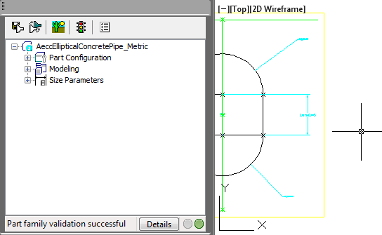

When you choose to create or modify a part, Part Builder opens a parametric building environment that includes a variety of features:
