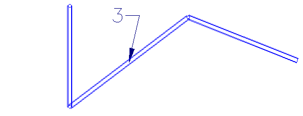

In the following example, the vertical pipe has been deleted, or detached from the other pipes. The result is that only the connected pipes to the right are now included in the span label. The label stays at the same location.
In the following example, the pipe to the left has been deleted, or detached from the vertical pipe. The result is that only the remaining pipes are included in the span. The label indicates the span is now comprised of three pipes.
