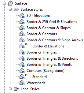

Use an object’s Styles collection in the Settings tree to manage styles for a class of objects.
The following illustration shows an example of a Settings tree object style collection:
