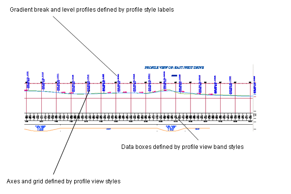

A profile view can include one or more related profiles, along with multiple data boxes along the X-axis, above or below the grid. Data boxes annotate the profiles with chaining, level, horizontal geometry, and other data that assists engineering analysis.

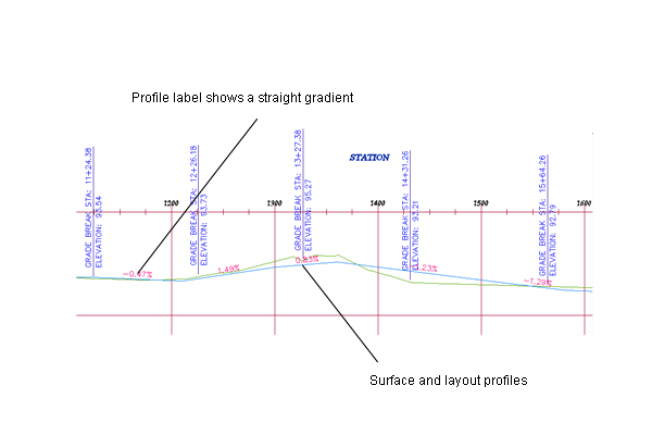

Profile view displaying surface and layout profiles
Closer view of surface and layout profiles
