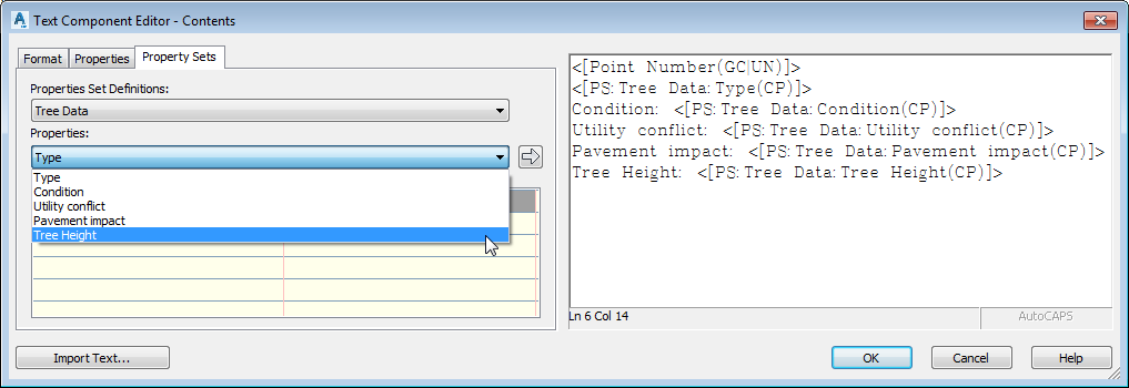

Using the Property Sets tab within the standard label style setup process, you can add these properties to point label styles so that you can label the points with this information.

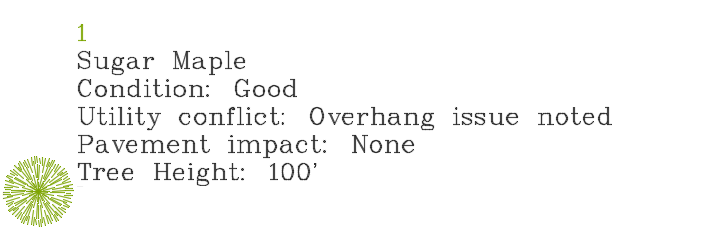

The following illustration shows a point labeled with tree data that is set up in a property set.

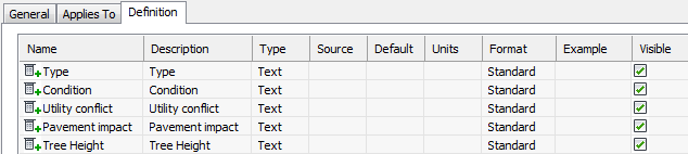

This label uses the following property set definition for the tree data:
The label style is set up as follows. You can use the Property Sets tab in the Text Component Editor to add the properties in the property set to the label style.

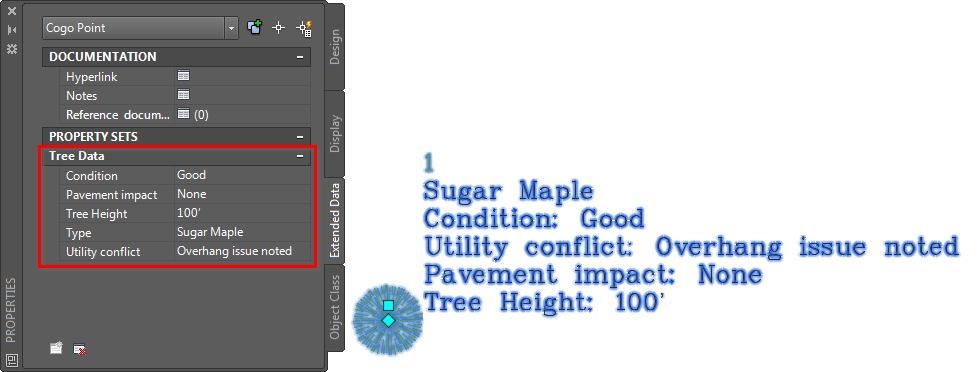

When applied to the points, the label style labels the property data that is defined for each point, as shown in the Properties Palette.

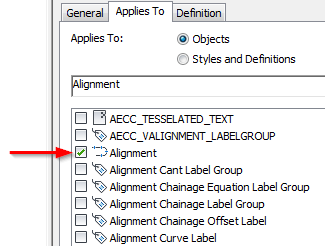

For most label types, on the Applies To tab of the Style Manager, select the object type you want to label, not the related object label type (for exceptions, see the following section). For example, to label alignments with property data, select Alignment when you set up the property set.
