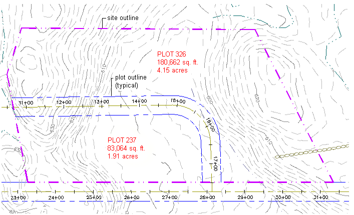

Plots in a collection can be either unattached or touching, but they cannot overlap. If you attempt to overlap two plots, the region of overlap defines a third plot. Similarly, if an alignment crosses a plot, it divides the plot into two plots. In the following illustration, before adding the alignment, the site was all one plot:
