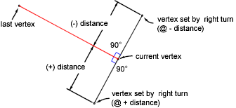

Define left and right turns, creating square sides on your figure. This is useful when drafting building footprints. At least two vertices must exist in the current figure for this command to work properly.
Survey Command Window. RT-TURN [distance]

The following illustrates the Right Turn command:
RT-TURN [distance]
Command Synonyms
RIGHT
RT
| Parameter | Definition |
| distance | The distance from the current vertex to the new vertex. Enter this value in the current survey database distance units. |
