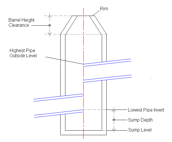

In AutoCAD Civil 3D, junction structures have built-in resize behaviors that control how far you can move the cover, connected pipes, and sump up and down.
For example, if you move the top-most pipe invert up, raising its level to the point where it reaches the top of the structure (cover), the cover moves up automatically. This is to ensure that the pipe remains connected to the structure below the vertical pipe clearance area. The resize behavior allows the junction structure to maintain the frame height, cone height, and honor the vertical pipe clearance area, at the top of the structure, with no pipes connecting in to that part of the structure.
If you try to move a connected pipe into the structure’s vertical pipe clearance area, you will notice in your drawing that the top of the structure (cover) automatically moves up.
This is just one example of the resize behavior that is built in to junction structures. Other resize behaviors control how far you can move the junction structure’s cover or sump up and down.

Understanding the Control Sump By Property
When you are moving a connected pipe down, there is a part property associated with the junction structure that affects the structure resize behavior in this situation. That property is the Control Sump By property, and it can be set to Depth or Level. When this property is set to Depth, the sump depth is controlled by the depth, based on the lowest pipe invert. When this property is set to Level, the sump depth is controlled by the level value of the sump. The resize behavior is different depending on how this property is set on the structure.
When a connected pipe is moved down, to a point where the pipe moves below the connected structure’s sump level, and the Control Sump By property is set to Depth, since the sump level is set to be controlled by the depth, then the sump level will be moved down, to a new level. This new sump level will be the depth of the lowest pipe invert, minus the sump depth value.
If a connected pipe is moved down, to a point where the pipe moves below the connected structure’s sump level, but the Control Sump By property is set to Level, then the sump will automatically move down, to a level equal to the lowest pipe level. This sets the sump depth to zero.
Using the sump depth grip, you can move a junction structure’s sump up to the point where it meets the lowest connected pipe. You will be prohibited, however, from moving the sump up past the point where it touches the lowest connected pipe.
When you move a junction structure’s sump down, the sump will simply move to the new level, and not affect any connected pipes, or the structure’s cover. This behavior is the same whether the sump is controlled by depth or by level.
