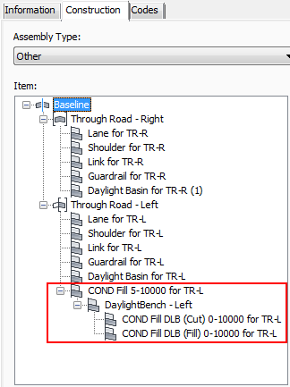

The next step is to assign descriptive names to each of the subassemblies in the conditional assembly. Assigning meaningful names to the subassemblies makes it easier to identify them when you are assigning targets, and helps you to identify subassemblies in the Subassemblies collection in Prospector.
Subassemblies that are added to the one side of an assembly display the default names, followed by the side to which they were added.
After assigning meaningful names to the conditional subassemblies, the final step is to set the corridor targets.
