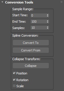

Conversion Tools rollout
Sample Range group
- Start Time/End Time
- Specifies the interval for the conversion. When converting from position keyframes to a spline object, this is the time interval for which the motion path will be sampled. If you're converting from a spline object to position keys, this is the interval over which the new keys will be placed.
- Samples
- Sets the number of samples for the conversion. When converting in either direction, the source is sampled at regular intervals, and keys or control points are created on the target object.
Spline Conversion group
- Convert To/Convert From
- Converts keyframe position tracks to and from spline objects. This enables you to create a spline motion path for an object and then convert that spline to keyframes for that object's position track in order to do various keyframe-specific functions (such as applying constant velocity to the keys and normalizing the time). Or, you can convert an object's position keyframes into a spline object.
Tip: Convert To and Convert From can be used to move an object along a path without using a path constraint.
Collapse Transform group
Generates keys based on the current transformation of the selected object. You can apply this for any type of transform controller assigned to an object, but the main purpose of this function is to "collapse" a parametric transform effect, such as one generated by a Path constraint, into standard, editable keys.
- Collapse
- Collapses the transform of the selected object.
- Position, Rotation, Scale
- Specifies which transforms you want to collapse.
You must choose at least one checkbox to activate the Collapse button.
