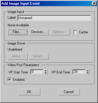

Add Image Input Event
The Add Image Input Event adds a still or moving image to the scene. Image Input events place an image in the queue, but unlike Scene events, the image is either a file that was saved beforehand or a device-generated image.
Procedures
To add an Image Input event:
  1. Make sure no events are selected in the queue.
  2. Click (Add Image Input Event).
    An Add Image Input Event dialog appears.
  3. Click Files to choose a bitmap or animation as the image, or click Devices to choose an image-generating device.
    If you click Files, a file dialog appears to let you choose the bitmap or animation file.
    If you choose Devices, a Select Image Input Device dialog appears. This dialog has a list of installed device options.
  4. Click Options to choose the size and placement of the image in the final video frames.
    An Image Input Options dialog appears.
  5. Adjust other Image Input settings, and then click OK.
    The Image Input event appears at the end of the queue.

Interface
The Add Image Input Event and Edit Image Input Event dialogs have the same controls.
Image Input group
Label
Lets you give the event a unique name. A unique name can make the image event easier to distinguish in a long list of events.
Files
Lets you choose the bitmap or animation image file.
Devices
Lets you choose an installed hardware input device; for example, a digital disk recorder.
Options
Displays the Image Input Options dialog to allow you to set up alignment, size, and frame range for the input image.
Cache
Stores a bitmap in memory. If you are using a single-image bitmap, you can choose this option. Video Post won't reload or scale the image for each frame.
Image Driver group
These buttons are available only when you choose a device as the image source.
About
Provides information on the source of the image-handler software used to bring the image into 3ds Max.
Setup
Displays a setup dialog specific to the plug-in. Some plug-ins might not use this button.
Video Post Parameters group
VP Start Time/End Time
Sets the starting and ending frames for the selected event within the overall Video Post queue. Video Post renders the event over the number of frames specified here.
Enabled
Enables or disables the event. When this box is off, the event is disabled and Video Post ignores it when rendering the queue. Each event must be disabled individually. For example, disabling a composite layer event does not disable the composited image events. The range bars of disabled events are unavailable in the event track area.
