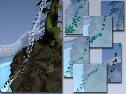

The controls on this rollout let you specify the type of particle used and the type of mapping performed on the particles.
Left: A stream from a fountain
Right: The same stream with various types of particles

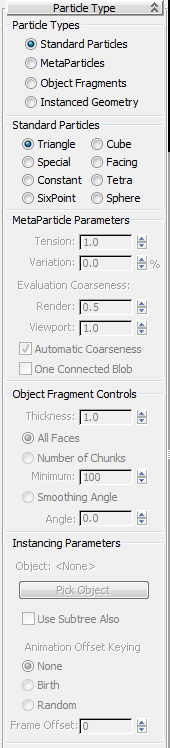

Particle Types group
These options specify one of four categories of particle type. Depending on which option you choose, different controls become available in the lower portion of the Particle Type rollout.
- Standard Particles Uses one of several standard particle types, such as triangle, cube, tetra, and so on.
- MetaParticles Uses Metaball particles. These are particle systems in which the individual particles blend together in blobs or streams.
- Object Fragments Creates particles out of fragments of an object.
Object Fragments is available only with Particle Array. Choose it when you want to fracture the particle emitter object and use the pieces as particles. This option is useful for animating explosions and shattering collisions.
The fragments are created at the Emit Start frame. The Use Rate, Use Total, Emit Stop, and Particle Size parameters are unavailable.
- Instanced Geometry Generates particles that are instances of either an object, a linked hierarchy of objects, or a group. The object is selected in the Instancing Parameters group on the Particle Type rollout.
Choose Instanced Geometry when you want particles to be identical instances of another object in your scene. Instanced geometry particles are extremely effective for creating crowds, flocks, or flows of very detailed objects. Here are a few examples:
- Instance a red blood cell and use Super Spray to animate blood flowing in an artery.
- Instance a bird and use Particle Cloud to animate a flock of birds flying.
- Instance a rock and use Particle Cloud to animate an asteroid field.
Note: Only one type of particle can be used for the particle system. However, you can have more than one particle array bound to a single object, and each particle array can emit a different type of particle.
Tip: Image motion blur, described in
Object Properties
Motion Blur group, is known not to work properly with instanced particles. Use object motion blur with instanced particles, or use image motion blur with standard particles.
Standard Particles group
When you choose Standard Particles in the Particle Types group, the options in this group become available. Choose one of the following options to specify the particle type:
- Triangle Renders each particle as a triangle. Use Triangle particles with noise opacity for steam or smoke.
- Cube Renders each particle as a cube.
Special
Each particle consists of three intersecting 2D squares. These are effective when you use a face-map material, described in Shader Basic Parameters Rollout, optionally along with an opacity map, to create the effect of a three-dimensional particle.
Facing
Renders each particle as a square that always faces the view. Use with an appropriate opacity map for bubbles or snowflakes.
- Constant Provides a particle that remains the same size, in pixels, specified in the Size spinner in the Particle Generation rollout
Particle Size group. This size never changes, regardless of the particle's distance from the camera. Attention: You must render either a camera or a perspective view for Constant particles to render correctly.
- Tetra Renders each particle as a mapped tetrahedron. Use Tetra particles for raindrops or sparks.
The default alignment of the tetra particles depends on the particle system type and emitter setup. To specify an alignment, use controls in the Rotation and Collision rollout.
- SixPoint Renders each particle as a six-pointed, two-dimensional star.
- Sphere Renders each particle as a sphere.

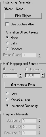

These options are used when you specify Instanced Geometry in the Particle Types group. They let you generate each particle as an instance of either an object, a linked hierarchy of objects, or a group.
Note: Instanced objects can be animated, providing the animation incorporates one or more of the following types:
- Animation of object geometry parameters, such as a sphere's Radius setting.
- Animation of object-space modifiers, such as the Angle setting of a Bend modifier.
- Transform animation of a hierarchical object's children. Transform animation of the top-level parent and non-hierarchical objects is not supported. For example, if you use the toolbar Select and Rotate function to animate a box rotating, and then use the box as instanced geometry with a particle system, the system will not use instanced box's keyframed animation.
- Object
- Displays the name of the picked object.
- Pick Object
- Click this, and then select an object in the viewport to be used as a particle. If you select an object that's part of a hierarchy and Use Subtree Also is on, then the picked object and its children become a particle.
If you pick a group, all objects in the group are used as a particle.
- Use Subtree Also
- Turn this on when you want to include the linked children of the picked object in the particle. If the picked object is a group, all children of the group are included. Note that you can turn this on or off at any time to alter the particles.
- Animation Offset Keying
- Because the instanced objects can be animated, the options here let you specify the timing of the animations for the particles.
- None Each particle duplicates the timing of the original object. As a result, the animation of all particles will be identically timed.
- Birth The firstborn particle is an instance of the current animation of the source object at the moment of that particle's birth. Each subsequent particle then uses the same start time for the animation. For example, if the animation of the source object is a bend from 0 to 180 degrees, and the first particle is born at frame 30, when the object is at 45 degrees, then that particle, and all subsequent particles will be born starting at a bend of 45 degrees.
- Random This option is the same as None when Frame Offset is set to 0. Otherwise, each particle is born using the same animation as the source object at the time of birth, but with a random offset of frames, based on the value in the Frame Offset spinner.
Frame Offset Specifies an offset value from the current timing of the source object.
Mat'l Mapping and Source group
Specifies how a mapped material affects the particles, and lets you specify the source of the material assigned to the particles. A detailed description of how materials affect particles is in the topic Using Mapped Materials with Particle Systems.
- Time
- Specifies the number of frames from the birth of the particle that it takes to complete one mapping of the particle.
- Distance
- Specifies the distance, in units, from the birth of the particle that it takes to complete one mapping of the particle.
Note: Tetra particles are an exception. They always have their own local mapping from head to tail, as described in the following section.
- Get Material From
- Updates the material carried by the particle system, using the source specified by the option buttons below this button.
Attention: Remember to click Get Material From whenever you choose a different source option button, or whenever you assign a new material to the specified source. Only a single material (or multi/sub-object material) is carried by the particle-system object at any time. Thus, when you change sources, you actually overwrite the currently assigned material with an instance of the source material.
- Icon The particles use the material currently assigned to the particle system icon.
Note: The Time and Distance options are available only when you choose this option.
- Picked Emitter The particles use the material assigned to the distribution object.
- Instanced Geometry The particles use the material assigned to the instanced geometry. This option is available only when you choose Instanced Geometry in the Particle Types group.
Attention: When you turn on either Picked Emitter or Instanced Geometry, an instance of the material from the chosen source is copied to the emitter icon, overwriting the material originally assigned to the icon. Thus, if you've assigned a material to the particle emitter, and then switch to Picked Emitter, the material originally assigned to the icon is replaced by an instance of the material carried by the picked object. If you then return to the Icon option, the particle system does not revert to the material that was assigned the icon, but retains the material taken from the picked object.
Fragment Materials group
These spinners let you assign different material ID numbers to outside surfaces, the edges and the back sides of fragment particles. You can then assign different materials to the front, edge and back of the fragments by using a multi/sub-object material.
- Outside ID
- Specifies which face ID number is assigned to the outside faces of the fragments. This spinner defaults to 0, which is not a valid ID number, forcing the outside of the particle fragments to use whatever material is currently assigned to the associated faces. Thus, if your distribution object already has several submaterials assigned to its outer faces, these materials are retained by using ID 0. If you want a single, specific submaterial, you can assign it by changing the Outside ID number.
- Edge ID
- Specifies which submaterial ID number is assigned to the edges of the fragments.
- Backside ID
- Specifies which submaterial ID number is assigned to the back sides of the fragments.
