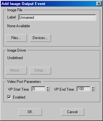

Interface
The Add Image Output Event and Edit Output Image Event dialogs have the same controls.
Image File group
Label
Lets you give the event a unique name. A unique name can make it easier to distinguish the output event in a long list of events.
Files
Lets you choose the output image file and its format.
Devices
Lets you choose the hardware output device; for example, a digital video recorder. The device, its driver, and its 3ds Max plug-in must all be installed on your system to use device output.
Image Driver group
The two buttons in this area are available only when you choose a device as the image source.
About
Provides information on the source of the image-handler software used to create the image from 3ds Max.
Setup
Displays device-specific setup options.
Video Post Parameters group
VP Start Time/End Time
Set the starting and ending frames for the selected event within the overall Video Post queue. Video Post renders the event over the number of frames specified here.
Enabled
Enables or disables the event. When turned off, the event is disabled and Video Post ignores it when rendering the queue. Each event must be disabled individually. For example, disabling a composite layer event does not disable the composited image events. The range bars of disabled events are unavailable in the event track area.
