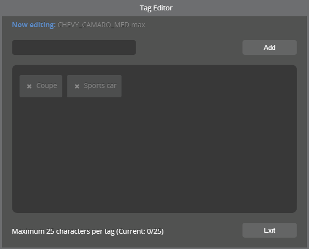

Tag Editor
Use the Tag Editor to add searchable tags to your assets. To save time, you can also copy and paste entire sets of tags directly from the Asset panel.
Tag Editor
To add a tag to an asset:
- In the Asset panel, move the mouse over a thumbnail and click
, or right-click an asset and choose Edit Asset Tags.
The Tag Editor opens.
- Type the desired name into the tag field and click Add. You can also press Enter.
- Repeat the procedure to add more tags.
- Click Exit to finish.
