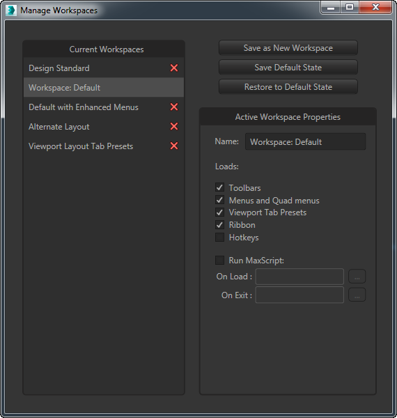

Choosing the Manage Workspaces command opens this dialog, where you can switch, add, edit, and delete workspaces.
To delete a workspace from the list, click the red X button to the right of its name in the list. You can delete only inactive workspaces other than the default workspace.

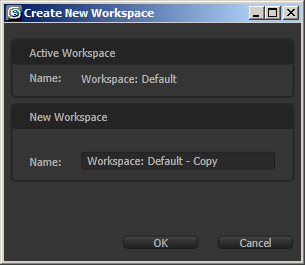

Clicking this button opens the Create New Workspace dialog:
The read-only Active Workspace parameter shows the name of the active workspace: the one being copied. The New Workspace parameter shows the name for the new workspace, which, by default, is the name of the active workspace with " - Copy" appended. To change the name, click in the Name field and enter a new name. To create the new workspace and add its name to the drop-down list, click OK. Or, if you change your mind, click Cancel.
After you create a new workspace, it automatically becomes the active workspace. Any subsequent changes you make to the workspace are saved to that workspace.

Use these switches to specify the categories of properties that are loaded from the saved workspace definition when you access the workspace. For any inactive property categories, the switched-to workspace inherits the active settings from the previous workspace.
