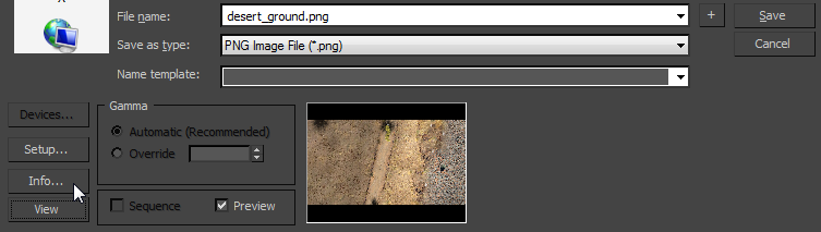

You can tell whether a particular file has an embedded gamma value by clicking the Info button on the bitmap file dialog.
If there is a gamma field, the information dialog shows the gamma value. If there is no gamma field, or if the field has not been set, the dialog shows "N/A".

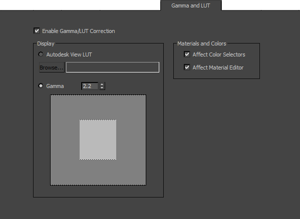

To enable gamma correction:
  1. Choose Customize menu Preferences and click the Gamma And LUT tab.
  2. Turn on Enable Gamma/LUT Correction, if necessary.
  3. In the Display group at the left-hand side of the panel, choose Gamma, if necessary.
    Note: If the gray square in the center of the gamma display contrasts greatly with the surrounding border, then the monitor's gamma correction is not good. You can use this dialog to adjust the gamma value, but we recommend that you leave gamma set to 2.2 and calibrate your monitor instead.
    Left: A bad gamma value
    Right: A good gamma value
  4. Click OK to confirm changes and close the Preferences dialog.
Makes available the controls for adjusting gamma or LUT correction. Turn off to disable gamma/LUT correction. Default=on.
Display group
Display gamma correction or lookup tables applies to viewports and the Rendered Frame Window. Use the controls in this group to load an Autodesk View LUT or adjust gamma numerically.
  • Autodesk View LUT Click the Browse button and then use the Load LUT File dialog to find and open a LUT file. Thereafter the LUT file name appears in the text field to the right of the button.
    Note: 3ds Max does not support generation of LUT files, and no LUT files are included with 3ds Max. To create a LUT file, use a program such as Composite.
  • Gamma (The default.) Adjusts the gamma display for 3ds Max. The spinner value increases or decreases the value (lightness or darkness) of the solid gray center square. The center square should appear as close as possible in value to the surrounding checkered border. You can use the spinner to adjust the gamma value, but we recommend that you leave gamma set to 2.2 and calibrate your monitor instead. Range = 0.1 to 5.0. Default=2.2.
Materials and Colors group
By default, the Gamma setting affects the viewport display and rendered frames, as well as the Color Selector and the Material Editor. These switches let you turn off gamma correction for either or both of these dialogs.
Affect Color Selectors
When on, the Gamma setting affects the display of colors on the standard 3ds Max Color Selector. and the Object Color dialog.
Affect Material Editor
When on, the Gamma setting affects the display of colors on the Material Editor dialog.
