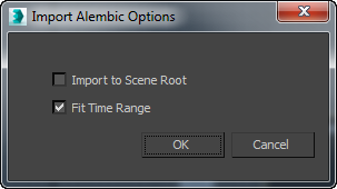

  3. Choose an ABC file to import, then click Open.
  4. On the import options dialog, set the options as appropriate, then click OK.
    Import to Scene Root
    When on, objects in the ABC file are imported to the root level of the scene, as "children of the world." When off, objects in the ABC file are imported as children of a Dummy object named Alembic. Default=off.
    Fit Time Range
    When on, changes the active time range to match the animation in the ABC file. Default=on.
    If the ABC file is not an animation, the active time range does not change.
