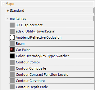

Maps and mental ray Shaders
When a mental ray renderer is active, the Material/Map Browser also lists mental ray shaders. Shaders are similar to maps, and you assign them the way you do maps.
mental ray maps in the Browser list
Tip: When the Default Scanline renderer is active, you can view mental ray shaders in the Browser list, and assign them, by choosing Material/Map Browser Options menu Show Incompatible.
