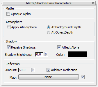

- On the Matte/Shadow Basic Parameters rollout, turn off Opaque Alpha, and turn on Receive Shadows and Affect Alpha.

Matte group
- Opaque Alpha
- Determines whether or not the matte material appears in the alpha channel. If you turn off Opaque Alpha, the matte object will not make an alpha channel, and the image can be used for compositing, just as if there are no matte objects in the scene. Default=off.
Atmosphere group
These options determine whether fog effects are applied to the matte surfaces, and how they are applied.
- Apply Atmosphere
- Turns the fogging of matte objects on and off.
When applying fog, you can choose between two different methods. You can either apply fog as if the matte surface is at an infinite distance from the camera or you can apply it as if the matte surface is actually at that point on the object being shaded. In other words, you can apply the fog to the matte surface in either 2D or 3D. The following controls determine how this is applied:
- At Background Depth This is the 2D method. The
scanline renderer fogs the scene, and then renders its shadows. In this case, the shadows won't be lightened by the fog. If you want to lighten the shadows, you need to turn up the shadow brightness.
- At Object Depth This is the 3D method. The renderer first renders the shadows, and then fogs the scene. Since this varies the amount of fog over the 3D matte surface, the generated matte/alpha channels don't blend perfectly into the background. Use At Object Depth when the matte object is meant to be a 3D object in the scene that the 2D background represents.
Shadow group
This group determines whether the matte surfaces receive shadows that are cast upon them, and how they receive them.
- Receive Shadows
- Renders shadows on the matte surfaces. Default=on.
- Affect Alpha
- When on, shadows cast on a matte material are applied to the alpha channel. This lets you render bitmaps with alpha channels that you can composite later. Default=on.
Affect Alpha is available only when Opaque Alpha (in the Matte group box) is turned off.
When Affect Alpha is on, the higher the Shadow Brightness value, the more transparent the shadow, allowing the background to show through more, and making the shadow appear brighter.
- Shadow Brightness
- Sets shadow brightness. At 0.5, the shadows will not be attenuated on the matte surface; at 1.0, the shadows are brightened to the color of the matte surface; and at 0.0 they are darkened to completely obliterate the matte surface.
- Color
- Displays a
Color Selector to let you choose the color of the shadow. Default=black.
Setting shadow color is especially useful when you're using a Matte/Shadow material to composite your shadows against a background image, such as video. It lets you tint your shadows to match pre-existing shadows in the image.
Reflection group
Controls in this group determine whether the matte surfaces can have reflections. You create matte reflections using a shadow map.
Tip: Matte reflections don't successfully create an alpha channel unless you render them against a black background.
- Amount
- Controls the amount of reflection to use. This is a percentage that can range from 0 to 100. This control is unavailable unless you have assigned a map. Default=50.
You can animate this parameter.
- Map
- Click to assign a
Reflection map. The reflection is independent of the scene’s
Environment map unless you choose a
Reflect/Refract map or
Flat Mirror map.
