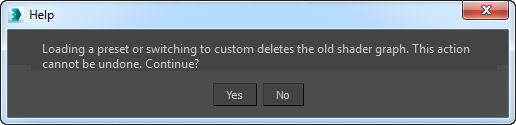

  2. Highlight the Standard Base node. On the node's Properties panel, choose Custom from the Parent Material drop-down list.
    3ds Max warns you that this will remove the remainder of the preset shader tree. Click Yes.
    Also, the Properties panel In Engine Material field is now empty.
